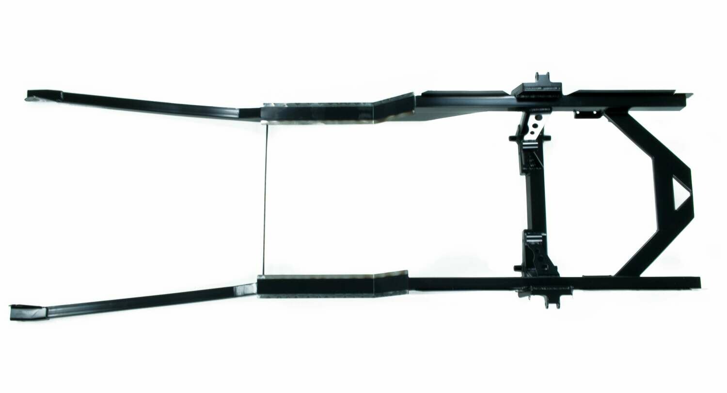

I'd go for a coyote with newer auto trans mission with a shift kit.
and the front subframe assembly with reinforcements from Mustangs to Fear.
Easier to access parts for the newer motors from Ford. Get it tuned to your liking or leave it as flashed from MARs.
Excellent. You just exceeded his budget by 1000%, and there’s nothing easier to get parts for than a SBF.
